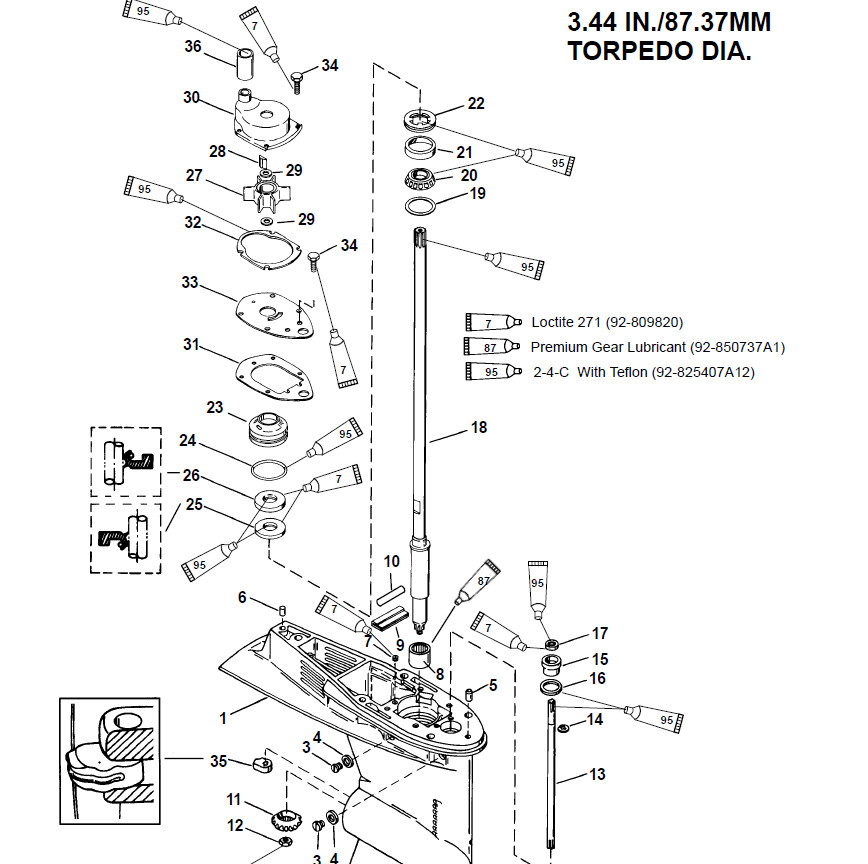

bonjour
ci joint photo embase
salutations
